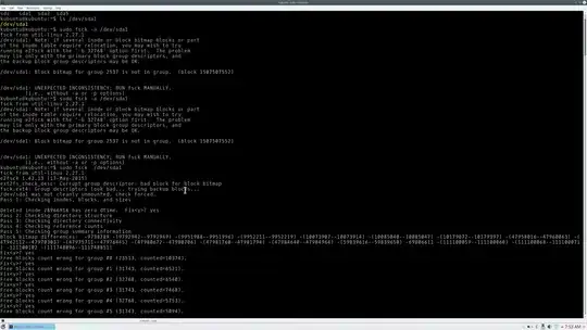

I have had the same problem today after resume from hibernation. I really don't know why this happens with Kubuntu 16.04 so much. This is what I got on live USB (Kubuntu 16.04)enter image description here and I just hit Enter until the end. This is a bit embarrassing because I most have live USB around. Do someone knows how to solve definitely this problem ?

i finally gave up, and installed 16.04 Xubuntu... and then after that booted properly, plugged my 16.04 Kubuntu live-disk and opted for the "Delete and install without reformating".
that way the correct boot structure that Xubuntu installed was left in place, but i could still use the OS that i wanted.
works like a champ since then.
