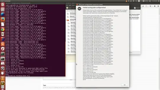

An error occurred while using update-grub & grub customiser.
I removed GRUB2 using sudo apt remove grub2 and reinstalled it with sudo apt install grub2 but still the problem persists.
screen shot

I have no problem with dual boot since I have options to boot both Ubuntu and Windows 8. The problem is that I cant change the list order in GRUB via GRUB customiser or use update-grub command due to syntax errors at line 245.
Contents of grub.cfg.new:

Finally got solved by using boot-repair. Install boot-repair in Ubuntu & open it. Proceed as per instructions. Detailed instructions can be found here on Boot-Repair - Community Help Wiki and use 2nd option.
