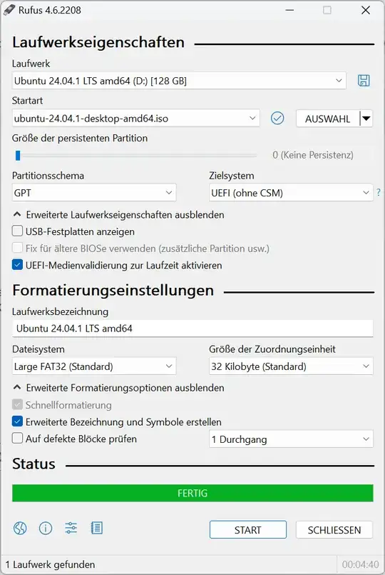

  • ISO image written to new USB stick with RUFUS (latest version). RUFUS printscreen

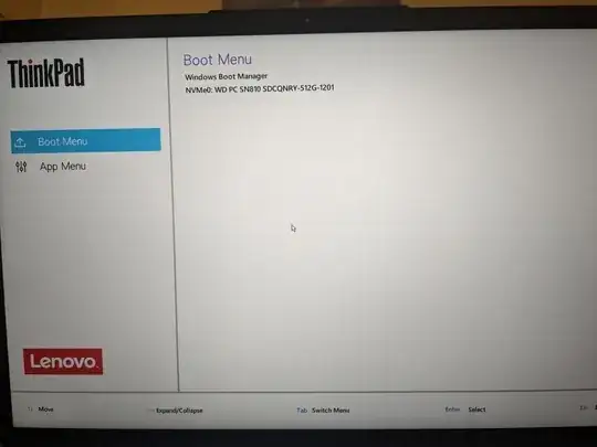

  • Also in the boot menu only Windows is available: boot printscreen

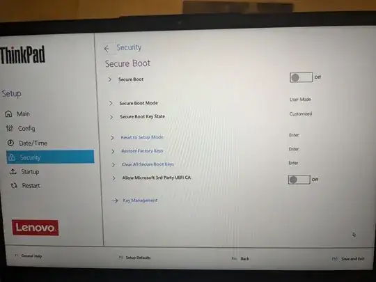

  • Secure Boot is off: printscreen

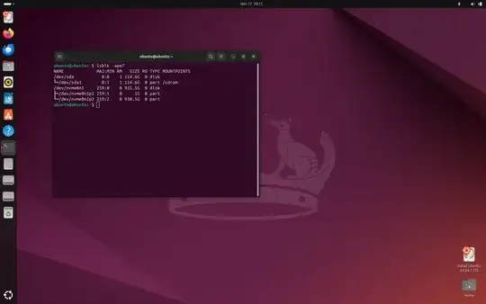

  • Restarting with USB-Stick plugged starts the installation process again. However if I cancel the installation menu window I after the media validation black screen I am suddenly in the Ubuntu desktop. Nothing here persists to the next restart of this type.
    Ubuntu desktop Printscreen

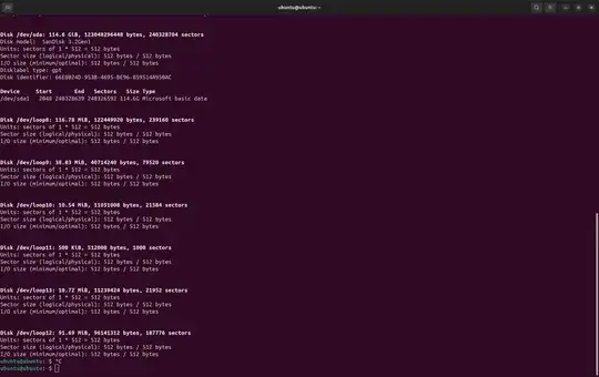

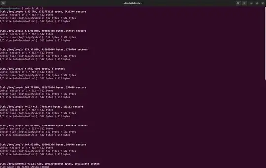

  • sudo fdisk -l
    sudo fdisk -l (part 1) sudo fdisk -l (part 2)

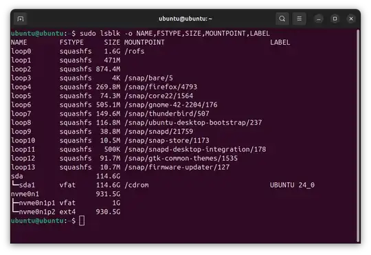

  • sudo lsblk -o
    sudo lsblk -o

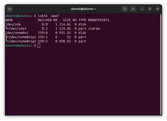

  • lsblk -ape7
    lsblk -ape7

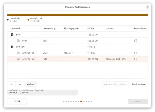

  • When I continue with the installation I am forced to manual partitioning and I see these partitions (I did not partition deliberately anything before). Here the continue button remains inactive, I cannot continue, no matter what I choose, including after overwriting new empty partition
    manual partitioning

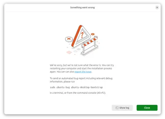

  • and later
    error message
