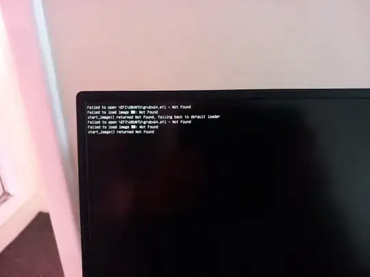

Each time I switch on I get the following:
Failed to open \EFI\UBUNTU\grubx64.efi - Not Found
Failed to load image __: Not Found
start_image() returned Not Found, falling back to default loader
photo of boot fail message
It then boots into Windows.
Please explain like I'm a kid, how I can make my laptop boot into Ubuntu again?

A recent windows update invalidated the grub secure boot signature. This would both prevent grub from booting windows and (after a bios update or bios key invalidation) may prevent grub itself from booting. This should not be an issue if your grub is up to date. Turning off secure boot would allow grub to boot long enough to update linux and then re-enable secure boot.
Having said that, I would expect different error messages from this problem. The former windows error would be something like "Verifying shim SBAT data failed: Security Policy Violation Something has gone seriously wrong: SBAT self-check failed: Security Policy Violation". If grub itself fails secure boot, the symptoms would vary by bios but may include mention of secure boot failure or just skipping grub entirely without any error. You can try disabling secure boot and see if that fixes it.
However, the "not found" errors make me suspect your EFI boot partition has been corrupted. The easiest way to fix this is to use something like refind to bypass the damaged grub and then run grub-install or the Ubuntu live disk to try to do a boot repair.
Ubuntu has a boot repair utility at https://help.ubuntu.com/community/Boot-Repair
