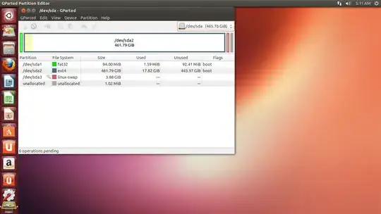

here is the gparted Screen shot Gparted

Try to install grub2 on /dev/sda through chroot method.See this How can I repair grub? (How to get Ubuntu back after installing Windows?).
Or
Try the second method on this page.
