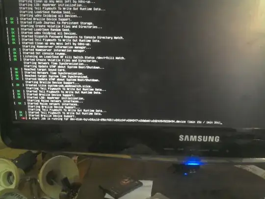

An image of what I'm talking about:
Ubuntu Desktop normally shows a splash screen during boot up, but for some reason (or perhaps an installation issue), in my PC, it shows a verbose list of messages in text mode.
May I fix this without reinstalling ubuntu?
Now I'm sure the origin of the problem is this:
  • I installed Windows and, since the boot-loader was modified with no dual boot available, I created a new GRUB file using Puppy Linux Live CD (FAST AN EASY SOLUTION). Almost everything ok, except the problem I'm stating here. Any ideas about how to fix it?

Well at the moment you are using puppy linux's grub4dos to boot
You need to reinstall Ubuntu's grub.
sudo grub-install /dev/sda  #if booting in legacy mode
or
sudo install-grub  #if booting in EFI mode
then
sudo update-grub
