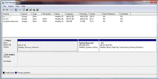

So What I did to dual boot was split a partion from my Ubuntu section. And then I installed windows onto the one that was empty. And now I can't access Ubuntu. When I startup there is no option on to enter Ubuntu.

That happened, because Windows has replaced GRUB at its proprietary bootloader and has changed MBR record.
Now you should repair your GRUB.
You can find instruction here.
