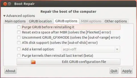

It is straightforward to use, and worked for me before. basic UI
and it allows yo to change kernel options as well: advance UI
