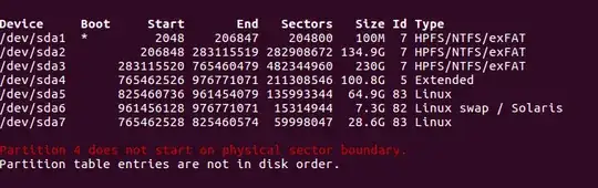

During original installation, I first installed Win7, and then ubuntu16.04 for which I created only 3 partitions: /, /home and swap area. Then for grub, gave location /sda. /dev/sda7 is my "/" directory and /dev/sda5 is my "/home". Later I also installed another kernel (for learning purpose) in my /home directory (as 'Linux' is being shown as 'type' for both /home and / in below image)
Also, below I am attaching result of 'fdisk -l' below:
Please help. thanks in advance.
