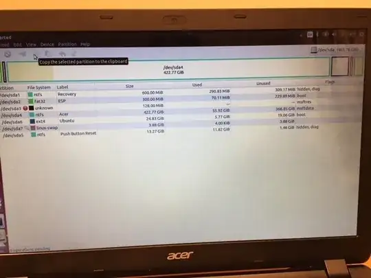

gparted screen picture from live cd

Neither Easyuefi nor EasyBCD saw my Ubuntu partition. They are talking about selecting the Linux partition and moving it "up" in the boot order. I can't see that partition anywhere but on gparted, and so can't move it "up".

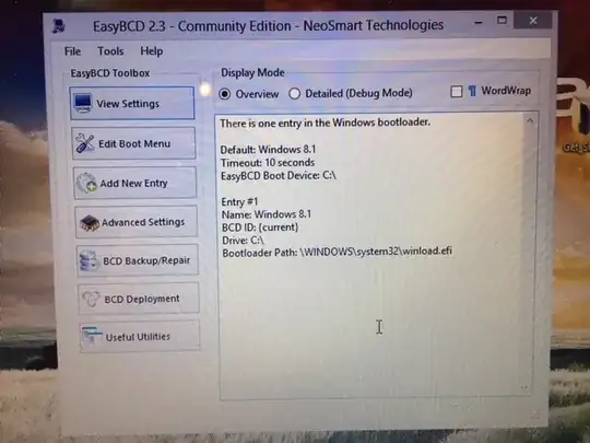

Message from EasyBCD

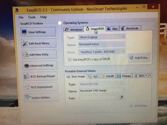

EasyBCD has detected that your machine is currently booting in EFI mode. Due to limitations set by Microsoft, many of EasyBCD's multi-booting features cannot be used in EFI mode and have been disabled. Linux doesn't show up and the tab it has the options greyed out.
EasyBCD 2.3 screen
EasyBCD 2.3 Linux/BSD screen
