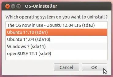

To delete Ubuntu from your Kubuntu:
  1. Install OS-Uninstaller in your Kubuntu session
  2. Run it, you will see a menu asking which OS you want to remove, similar to the one below: enter image description here
  3. Select Ubuntu (sda6), click the OK button.
  4. Finished !
EDIT: At this point, your question is fully answered: your old OS will be deleted, its space will be freed and accessible from Kubuntu, so you can use it the way you want (you can put data in it, or install another OS in it, or else). Optionally, you can repartition your disk the way you want, but that's a risky operation, and as you did not ask it, I would not advise it.
