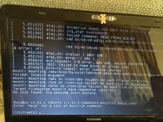

I was just starting my computer, I have version 2.02~beta2-9ubuntu1.4 and I keep getting this what should I do?

You have either a file system problem or a failing hard drive.
First boot from a live media to confirm exactly what the issue is.
Check SMART status of the drive to see if it's failing
If you have critical data on the drive you and you don't have a backup you should create a backup image on an external drive before continuing.
Boot from Live media and open a terminal and run fsck /dev/sdXY (where X is the drive designator {it appears to be a in your case} and Y is the suspect partition number) to attempt to repair the filesystem. The answer to Fix? is Y
If any of this is unclear please edit your question to include what you tried and the results and leave me a comment.
