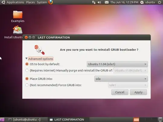

In addition to @ashutosh answer, you can use a graphical utility called Boot Repair to re-install Ubuntu bootloader:
Picture: Boot Repair
There's also a detailed article in Ubuntu wiki which lists different ways of recovering the bootloader after installing Windows
