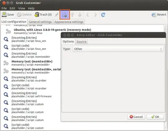

You can download and install GRUB Customizer. Not simple to use, but it may help, and it's better than editing the Bootloader menu by hand :)
To download, open Software Center and search for grub customiser. Install this programme the when you run it, you will be presented with:
GRUB Customiser
I do not have Windows, so I do not know what you need to add, but this should be a start.
