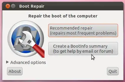

Boot-Repair is a simple tool to repair frequent boot issues you may encounter in Ubuntu like when you can't boot Ubuntu after installing Windows or another Linux distribution, or when you can't boot Windows after installing Ubuntu, or when GRUB is not displayed anymore, some upgrade breaks GRUB, etc.
Remark: this can also be performed from a live-CD or live-USB.
Either add ‘ppa:yannubuntu/boot-repair’ to your Software Sources via the Software Centre or, for speeds-sake, add it using a new Terminal session:
sudo add-apt-repository ppa:yannubuntu/boot-repair && sudo apt-get update
sudo apt-get install -y boot-repair && boot-repair
Boot-Repair can be installed & used from any Ubuntu session (normal session, or live-CD, or live-USB). PPA packages are available for Ubuntu 10.04, 10.10, 11.04, 11.10, 12.04 and 12.10. source
