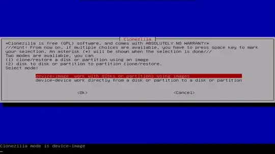

You can use Clonezilla for this purpose.
Clonezilla is a free partition and disk imaging/cloning tool which can be used to backup all your data (whole disks or partitions) in a highly compressed way and later clone it back to your hard disk to get it into the exact same condition. This is faster than installing the OS most of the times.
  • Download Clonezilla stable ISO
  • Make a bootable (live) USB using the built-in Startup Disk Creator application or Tuxboot 7.0.
  • Boot from the created Clonezilla media.
  • Now you have many options:
    1. Create an image of only '/' (saveparts) and clone it to any partition of your other SDD.
    2. Create an image of the full disk (savedisk) and clone it to your new SSD.
Clonezilla screen shot
In your case you can use the "device-device" option too, but I am not familiar with it.

Severus Tux'answer - about using Clonezella
This is also good way to go but will take more time in preparation and set up in comparison to using dd command - Clonezella Live USB stick must be prepared, booted, and many menus of Clonezella UI must be went through before starting the process of cloning or saving an image of the system. Clonezella works in the similar way as dd - UUIDs, PARTUUIDs will be copied to target SSD drive also.
Discussion about UUIDs, PARTUUIDs on Clonezilla page:
