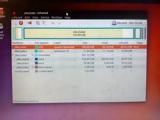

Since posting I tried to run the live cd and repair GRUB and I also installed 17.04 on unallocated space as I thought that doing so might repair the bootloader. I also did this to make sure that I could still access the files in the sda6 partition. I can although some say that I don't have permission to access.
This is my HDD in GParted in live CD/USB:
photo of screen with partitions in gparted
Those are all of the partitions. The 23.08GB (sda7) is new since I posted the pastebin link. All the other partitions are as they were though.

Boot repair didn't work when I tried with a USB and the terminal commands didn't work either, but when I booted the live USB and installed boot-repair then ran it and told it to install to the new partition sda7 (the one with 17.04). I rebooted and the GRUB menu appeared!! I can now choose the 16.10 from the menu and it boots fine.
It does take longer now and when booting there are a lot of messages like starting... such and such.
Windows boots fine and 17.04 boots fine also. I might try to start using 17.10 as I can access all my files on the 400gb 16.10 partition from there.
I should mention that before doing all that I restored the MBR with the Boot-Repair Lubuntu tool.
