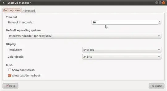

If you get to start ubuntu by the temp soln then to make boot permanently show the grub-
Open startup manager(install it if it isnt installed from sofware center)
Change the value for timeout- pref 5 - 10 secs
Default OS - Whatever you want
Rest leave everything as it(you can edit that if you want to)
