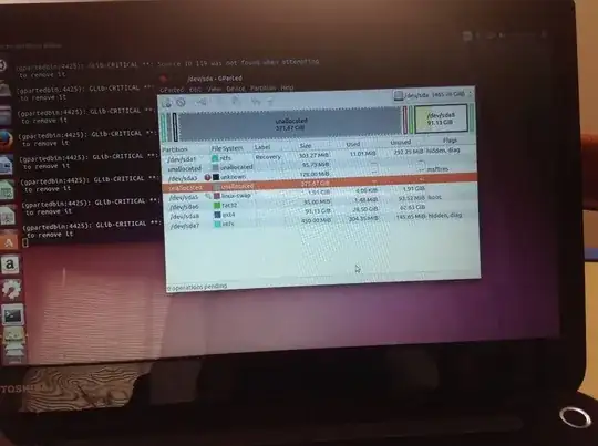

I deleted /dev/sda3, and now my system won't boot. I tried to use boot repair; but, it shows me an error message that says
GPT detected. Please create a BIOS-Boot partition
I created one but it doesn't work.
Gparted in photo of screen
The image above shows the /dev/sda3 partition before it was deleted
This is what it shows now (@Pilot6)

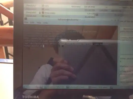

photo of screen showing terminal window below gparted window, hard to read

You moved the first sector of your Ubuntu boot partition. That is why the loader does not know where to find it.
This can be easily fixed.
  1. Boot from a LiveUSB.
  2. Mount you Ubuntu partition to /mnt. I see that you have done that already. But in case you boot again run:
    sudo mount /dev/sda8 /mnt
    sudo mount --bind /dev /mnt/dev
    sudo mount --bind /proc /mnt/proc
    sudo mount --bind /sys  /mnt/sys
  3. Then chroot and update grub:
    sudo chroot /mnt
    sudo update-grub
    exit
  4. Reboot to Ubuntu a normal way.
You can also try Boot repair. But you need to know that your Ubuntu partition is sda8 and the EFI partition is sda6.
Pilot6
  • 92,041
Try to install grub again, run these commands in terminal.
sudo grub-install /dev/sda
then run
sudo update-grub
Then follow Pilot6 answer.
