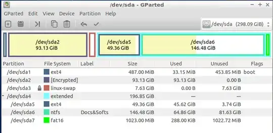

This is screenshot of my partition structure (as GParted shows): enter image description here
/dev/sda2 is the partition that is encrypted and contains /etc/, /root/, /lib/, /run/ and other Linux OS default folders and was mounted (at my previous working Lubuntu) as / i.e. system root.
/dev/sda5 is the partition that is not encrypted and was mounted (at my previous working Lubuntu) as /home/ folder.
