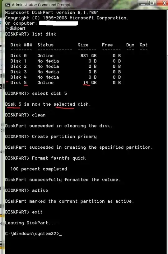

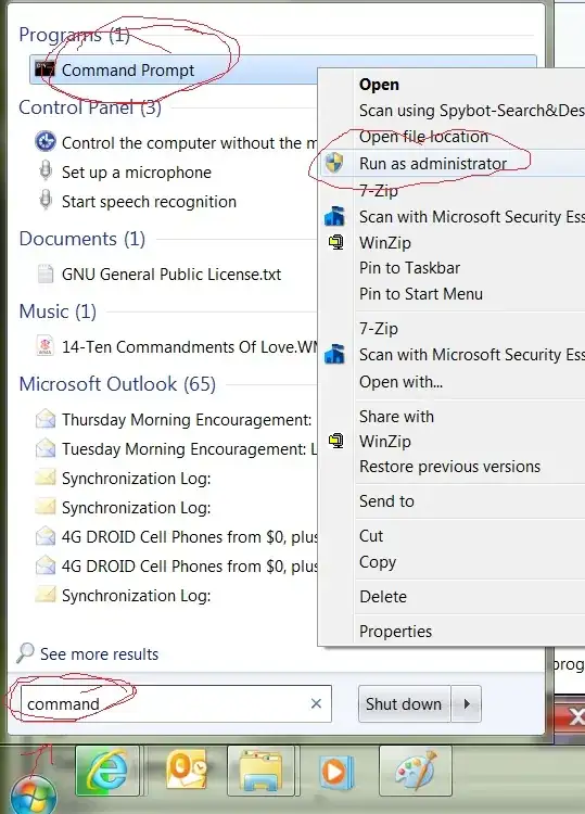

2- Insert your USB drive and run the following commands in the Windows command prompt, one line for each command. enter image description here
diskpart (Start the Windows disk management command line tool.)
list disk (This command will list all disks.)
You'll be able to use this command to search for your USB drive's number ('Disk ###'). You should be able to tell what's the right one by its size, but be careful, as the following commands will erase all contents currently on the drive.
select disk ### (Replace ### with your 'Disk ###' This is 5 in my example, so it will be "select disk 5" for me.)
clean (This will remove the partitioning information currently on the disk, effectively 'removing' all data on the disk.)
create partition primary (This will create a new partition.)
select partition 1 (This will select the partition so it can be used by following commands.)
active (Will make the newly created partition active.)
format quick fs=fat32 (UEFI can only USB boot to FAT32, not NTFS.)
assign (This will mount the USB drive.)
exit (This will leave the 'diskpart' program.)
Looks kindof like this but make sure to format in fat32 unlike I did in my picture enter image description here

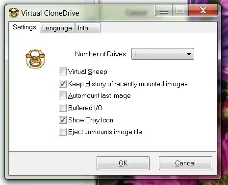

3- Download and install Virtual CloneDrive this is and iso emulation program, run the program and change the settings to these-

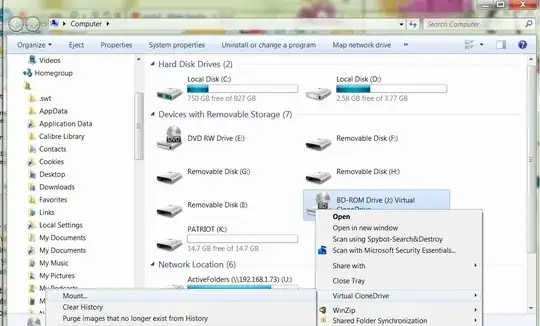

This will set up a virtual drive so we can mount the Windows 8 ISO file, and speedily transfer to the USB drive. So now we want to navigate to "Computer" to see your new "BD-ROM" dive. Right click on it and select "Virtual CloneDrive", then "Mount", as shown below-
Next navigate to where you saved your Windows 8 ISO file, select it and click Open.
