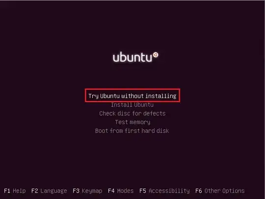

Boot into the Ubuntu 12.04 Live CD and click "Try Ubuntu without installing": enter image description here After the desktop is loaded, we need to mount the root partition so that we grant the live cd user read/write permissions on your system files and folders. Let's first identify the partition where Ubuntu is installed with this command:

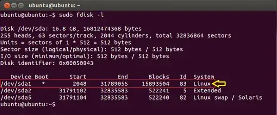

sudo fdisk -l
Note: The Terminal can be started by pressing CTRL+ALT+T.
The Ubuntu partition we will work on will be labeled with the word "Linux" as shown in the screenshot given below:
