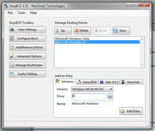

at first install the free software 'EasyBCD' (current version is 2.2) in your windows 10 system. Then run it. In EasyBCD, click on "Add New Entry" and select "Linux/BSD" and change the type to "GRUB 2" and name it "Ubuntu". And then Click on "Add Entry". Go to "Edit Boot Menu" and click on "Save settings". And then you are good to go. You can also change the order of boot menu during power up from the "Edit Boot Menu" option. enter image description here
