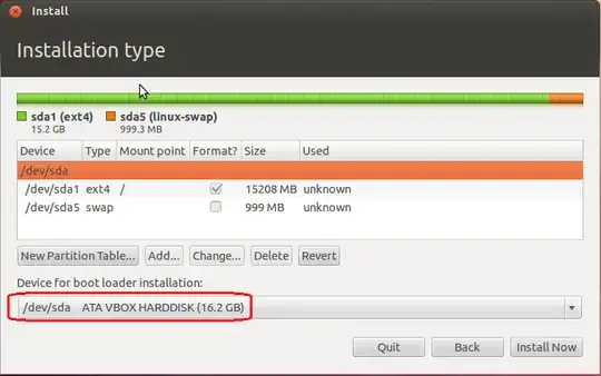

As it has been determined in the comments, sudo dd if=/dev/sdb iflag=fullblock bs=512 count=1 2>/dev/null | strings showed no trace of GRUB on the device.
So the problem is that the device lacks a bootloader, which explains why trying to boot it didn't avail: the BIOS of the machines in question simply fell back to a bootloader present on another device to boot an OS, which had the effect of booting another OS.
The fix is either installing GRUB on the device or reinstalling Ubuntu on the device making sure that GRUB gets installed to the right device:
s1
