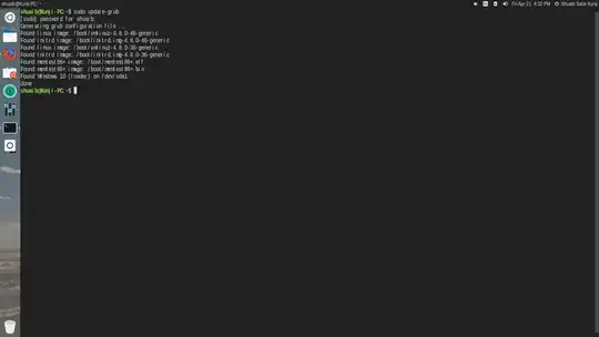

Check to see if your motherboard has a boot device option. I have legacy motherboard - Gigabyte H67MA-D2H B3. I installed Ubuntu in dual boot but on seperate HDD. Pressing F12 during boot, brings up an option to select the Boot Device listing installed HDD's etc. Select HDD where Ubuntu is installed and it will boot it.
Found a better workaround. Just go to the boot menu in your bios and and set the "Ubuntu" bootloader to #1 priority(i.e. move it up the list of boot devices till it reaches the #1 in the list). Save the settings and exit. It should boot Ubuntu now or more likely show you the GRUB menu. If in the GRUB menu your Windows 10/8 bootloader is not listed(highly unlikely), don't panic. Just boot into Ubuntu, open the terminal and run
sudo update-grub
This is what my system shows: terminal It should list the Windows 10/8 bootloader in the GRUB menu now. Hope that helps.
P.S. This workaround only works if you have ONLY ONE HDD/SSD on your machine.
