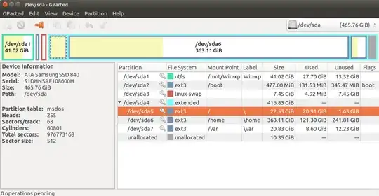

See the ext3 partition seen under gparted as /dev/sda5 with mount-point / below.

Using Gparted, can I actually move those 41.02 GiB of free space (now making up /dev/sda1 and to be formatted as ext3) in such a way that it be merged (at least partially) with /dev/sda5 (/). Could someone explained the sequence of actions to be applied, following the pattern below ?
It would involve the sequence:
  • merging /dev/sda2 with /dev/sda1 as one larger ext3 partition
  • shrinking the result to 477 MiB ext3 to the left (present /dev/sda2 size)
  • making the newly unallocated 41.02GiB space, now right of /boot, swap space.
  • merging it with the present contiguous 7.45 GiB of swap-space
  • shrinking the resulting 48.47 GiB swap space to 7.45GiB to the left.
But then how do I merge the resulting unallocated 41.02GiB space now right of linux-swap with the extended partition /dev/sda4` ?
