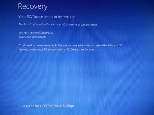

Update Right now getting this error...i am using the recovery USB driver from Windows 10 only...it should work...but not working...how i can completely wipe out my entire hard driver contents and make sure that Windows recovery drive is recovering my PC...i am ready to loose data if need to be.
Now Windows 10 recovery is also not happening. I am stuck at this screen for ever.

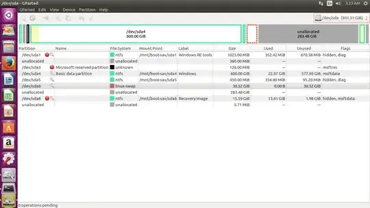

Somehow used the Ubuntu Live USB(16.06 LTS)...try ubuntu and this is how it looks like in gparted.
and this is the pastebin contents
