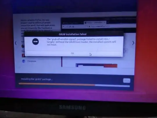

When I'm trying to install Ubuntu 18.04 on my desktop, it shows the following error:
error popup with ubiquity
The 'grub-efi-amd64-signed' package failed to install into /target/. Without the GRUB bootloader, the installed system will not boot.
How to fix this error?
