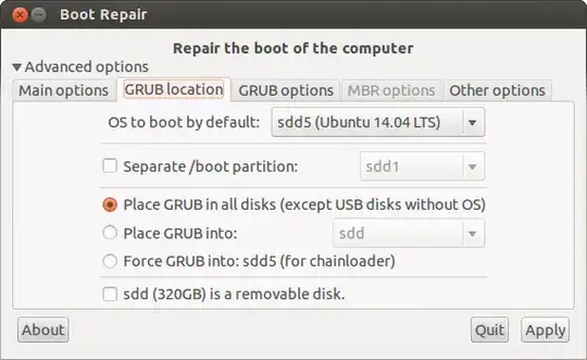

  1. You have to repair the MBR of the internal HDD using a Windows CD/DVD. (startup-repair)
  2. Attach the secondary disk, boot using a live CD and then use boot-repair tool to install GRUB on your secondary HDD. See the picture below:
    Choose Place Grub into - your secondary HDD from the dropdown menu.
    To identify the name of your secondary HDD, open explorer, and see the Boot-repair tool instructions.
