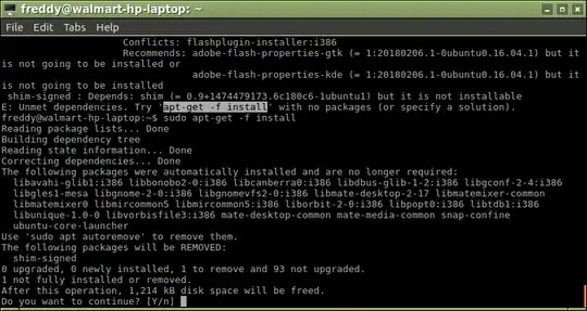

try:
sudo apt-get -f install
step 1: start the shim uninstall
then: this terminal command will remove the shim-signed archive

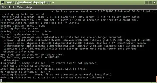

step 2: shim uninstalling
after: with the shim archive removed successfully

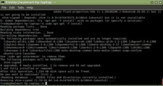

step 3: shim removed
finally: at least the Ubuntu software updates should start working again if it all goes well (as in my case)
step 4: System updates prompt
