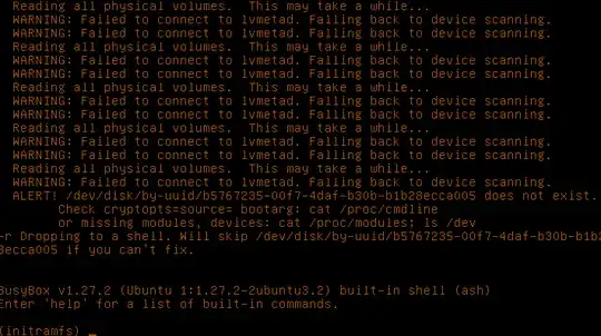

If I wait for long enough I get dropped to an initramfs screen, and upon trying to exit it I get this behaviour.
Playing around with enabling/disabling 3D acceleration and changing VirtualBox graphics driver don't seem to work.
initramfs screen
