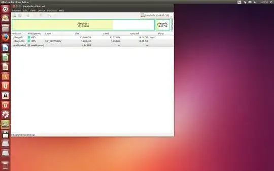

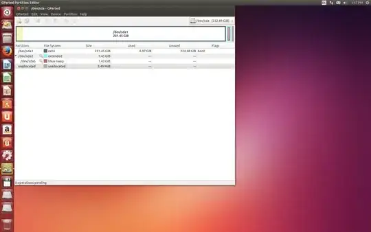

Sorry to ask what must be an oft-asked question but I am not seeing another thread with the solution. I am trying to install Ubuntu 13.10 for a dual boot setup on a system that has two HDDs on it, one 149Gb the other 249Gb .
Windows 7 is already installed on the 149Gb drive. When I just run the Ubuntu installation from USB, it defaults to the 249Gb drive. WHen I restart, my system goes straight into Windows 7, no Dual Boot option on startup.
From my reading I think I need to push the Ubuntu install to the same device as Windows now occupies. I started down the last option in the Install (something along the lines of "manually install by specifying partitions") but that leads me to a partitioning type screen that I don't feel like messing with. can someone advise or direct me to the step by step instructions I need.

IN the end I just took the inelegant approach of disconnecting the 2nd HDD, and redoing the Ubuntu installation on the sole primary drive. This time it prompted me as described in the install steps to allocate space between Windows and Ubuntu. I reconnected the 2nd drive and on reboot, I got the Dual Boot prompt choices. There must be a more elegant approach but this got the job done.
