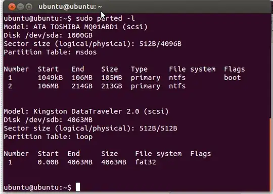

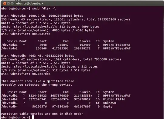

Partitions on my 1TB HDD:
  • 100MB ntfs (win 7 installation made it automatically)
  • 200GB NTFS (Win 7 partition)
  • 4 GB Partition (I don't know what fs type)
  • rest all unallocated
Edit: Yesterday I deleted the unused 4 gb partition current OS is running on live usb fat 32
The result of fdisk -l
Result of sudo parted -l
