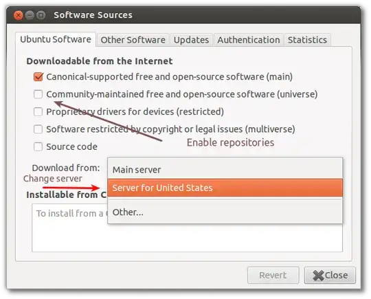

  • Open Software & Updates
      software-properties-gtk
This will open software-properties-gtk with no repository selected.
Then, change the server to Main server or to any other server of your choice. You must enable some repositories from the new window in order to create a new sources.list file in /etc/apt/.
ubuntu-software tab of software-properties-gtk

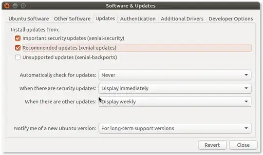

  • After enabling some sources from Ubuntu software tab, you can enable updates. To do so, switch to Updates tab and select one or more updates channel. I recommend selecting the security and updates channels at least. (This image is later added from Ubuntu xenial, so there can be some differences)
updates tab of software-properties-gtk
