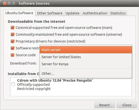

Open up your Software Center by going to the dash and searching for it.
In the menu, select "edit"->"software sources".
In the pop-up window that opens, there will be a 'Ubuntu software' tab (the first one) and a 'Download from select option'. Choose 'Main server' and enter your password.
Then try running sudo apt-get update && sudo apt-get upgrade in terminal.

First Check that did you have an working internet connection.And also select Best server for downloading packages from software and updates.
Then update the repositories and try to install packages,
sudo apt-get update
sudo apt-get install <package name>
