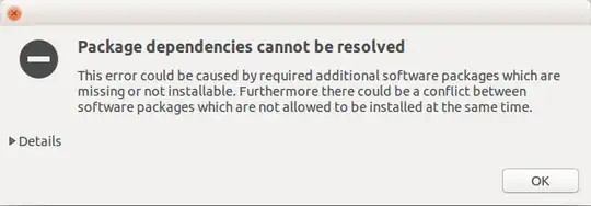

When I try to install anything from Software Center either
It shows me this error:
[package dependencies could not be resolved
When I go to Software Center > Edit > Software Sources is disabled.
