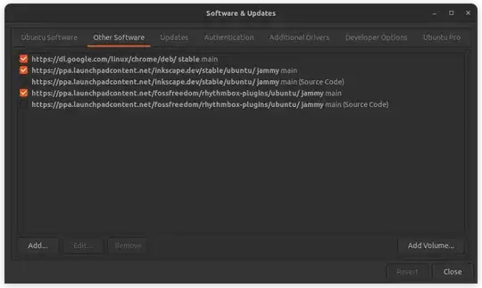

The AtomEditor was previously installed in this system but was removed after it was discontinued. Seems that the removal is incomplete despite not appearing in Software & Updates - Other Software.
