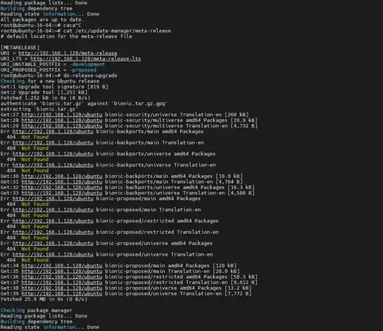

I have issue when upgrading using the step do-release-upgrade, some links result in "404 Not found".
This issue is shown in this screenshot:
Screenshot of do-release-upgrade output
How can I resolve it, as I am concerned that it will affect the system?
Host local repo Ubuntu 20.04.3 LTS

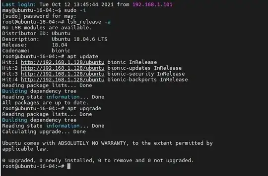

========== Update 2021-10-12 ========== This is screen short before upgrade with using command apt update: This is screen short before upgrade
This is screen short after has finished upgrade major version xenial to bionic: Screenshot of Done upgrade 16.04 to 18.04 output
Is it ok to ignore the issue above?
