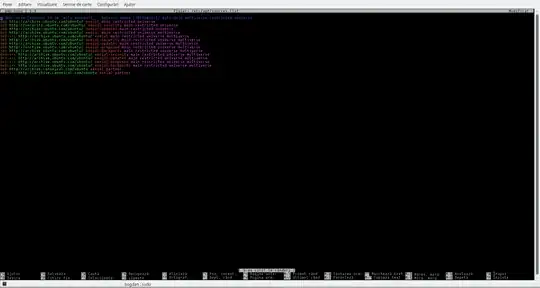

And this is my /etc/apt/sources.list:

main, universe, multiverse, restricted are different components of the Sections portion in a sources.list entry and can not be duplicated for a given entry (same Type (e.g. deb), URI (e.g. http://archive.ubuntu.com/ubuntu/) , Suite (e.g. xenial)).
In your /etc/apt/sources.list, you have duplicate components (main, restricted, universe) in lines 2 and 5:
deb http://archive.ubuntu.com/ubuntu/ xenial main restricted universe
deb http://archive.ubuntu.com/ubuntu/ xenial main restricted universe multiverse
As line 5 is a superset of line 2, you can remove line 2 using your favorite editor or use sed:
sudo sed -i '2d' /etc/apt/sources.list
Or comment out the 2nd line:
sudo sed -i '2 s/^/# /' /etc/apt/sources.list
