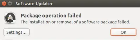

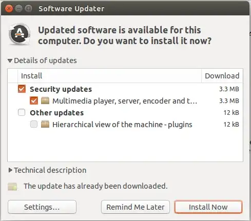

After I installed virtualbox, I cannot install some packages. So I removed virtualbox, then I still cannot install the packages.
  • This is the package:
  • And this is the error I received.

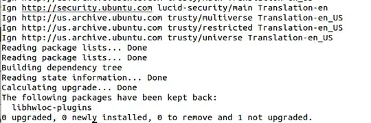

  • After I ran sudo apt-get update && sudo apt-get upgrade, there is no error and the result is as this:

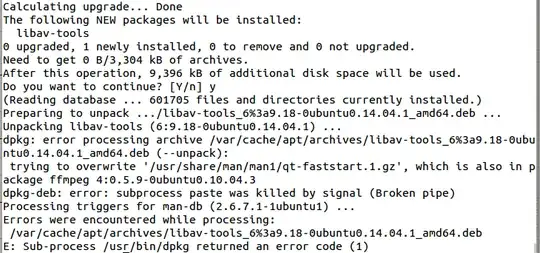

  • After I ran sudo apt-get dist-upgrade, I was asked to install libav-tools, then I chose y, and then the error appeared.

Ok, here is the short answer.
sudo apt-get remove ffmpeg
sudo apt-get install libav-tools

  • 92,125
Run
sudo dpkg --configure -a
sudo apt-get -f install
sudo apt-get update
and if that doesn't help
cd /tmp
wget http://de.archive.ubuntu.com/ubuntu/pool/universe/h/hwloc/libhwloc-plugins_1.8-1ubuntu1_amd64.deb
sudo dpkg -i libhwloc-plugins_1.8-1ubuntu1_amd64.deb
