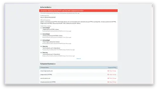

It seems there is currently an ongoing issue with http ubuntu repositories (via port 80). See the status at https://status.canonical.com/
I worked around this issue by switching archive URL that fails from http with https. Something like this:
sudo sed -i 's|http://archive.ubuntu.com|https://archive.ubuntu.com|g' /etc/apt/sources.list
Unfortunately, doing the same for security.ubuntu.com didn't seem to work, as the HTTPS endpoint is unreachable for me right now... Fortunately, it seems to come back from time to time... maybe it's just flaky and it does work, not sure
