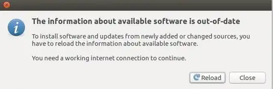

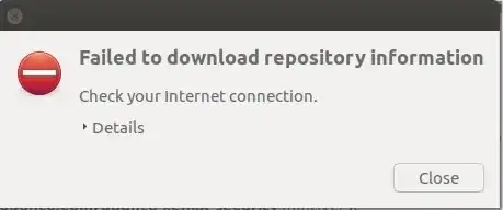

  • I should mention that when I add a new source to the list, and press "Reload" in the following pop-up
I get the following error even though I have a working internet for sure.
