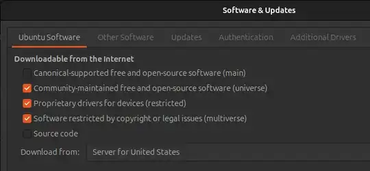

I do not know how this happened but the "Software & Updates" app showed that somehow the "Canonical-supported free and open-source software (main)" was deselected. Selecting, updating & installing then worked as expected.
Thanks to all who commented & let me know this should work.
