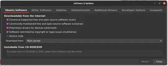

I was able to install Lutris after enable all checkbox in Software & Updates as in the attached figure below.
  • Canonical-supported free and open-source software (main)
  • Community-maintained free and open-source software (universe)
  • Proprietary drivers for devices (restricted)
  • Software restricted by copyright or legal issues (multiverse)
Software & Updates - img
