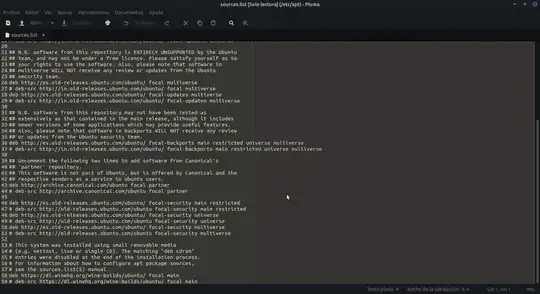

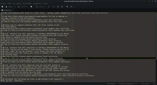

Sources.list part 1:
Sources.list (part 1)
Sources.list part 2:
Sources.list (part 2)
