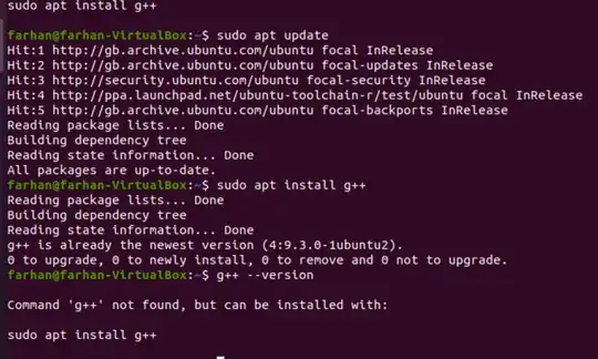

I installed Ubuntu 20.04 and I installed g++ using
sudo apt install g++
sudo apt install build-essential
but when I want to check the version using this command
g++ --version
it showed me and also for gcc same the situation
Command 'g++' not found, but can be installed with:
Is there any way to check whether the g++ installed or not?
you can see the photo

Steps you can try:
  • Try sudo apt update before running sudo apt install g++.
  • Restart the Terminal. (If you connect via SSH, try reconnecting.)
  • Remove the g++ with sudo apt purge g++, and reinstall it.
If you want to know if the package installed, check out this answer.

Yes you can check installed tools via this command :
sudo apt list --installed
In your case, "g++" is not installed. Try updating the repositories before installing via these commands :
sudo apt-get update -y && sudo apt-get install g++ -y
