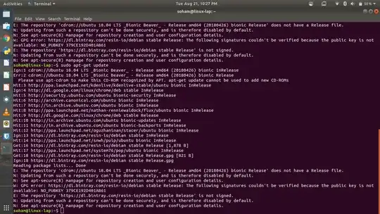

The Terminal Update(Screenshot)
When I try to update my laptop running Ubuntu 18.04.1 LTS I use the commands sudo apt update and sudo apt-get update and every time I get this message:
E: The repository 'cdrom://Ubuntu 18.04 LTS _Bionic Beaver_ - Release amd64 (20180426) bionic Release' does not have a Release file.
N: Updating from such a repository can't be done securely, and is therefore disabled by default.
N: See apt-secure(8) manpage for repository creation and user configuration details.
W: GPG error: https://dl.bintray.com/resin-io/debian stable Release: The following signatures couldn't be verified because the public key is not available: NO_PUBKEY 379CE192D401AB61
E: The repository 'https://dl.bintray.com/resin-io/debian stable Release' is not signed.
Has the OS updated? What should I do so that it updates?
