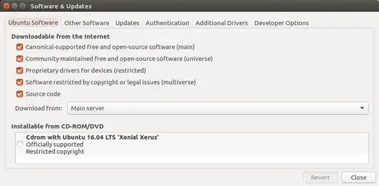

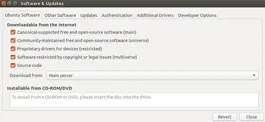

Have you tried changing the repository to the 'Main server'? Whenever you change it and close, it will prompt you to reload. That should restore the defaults.
repositories in Software & Updates

#2 Fix for missing /etc/apt/sources.list
Simply open Software & Updates via your Dash and you will see this
enter image description here Select desirable mirror, then activate checkbox to enable repositories (main, universe, restricted, multiverse) in order to create new sources.list file
