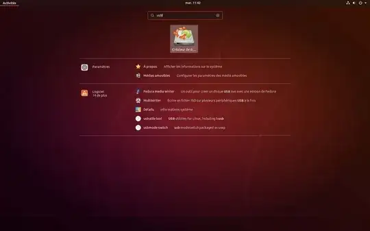

as the new user you are, I would strongly recommend you not Upgrade your ubuntu and instead download ubuntu form here : https://www.ubuntu.com/download/desktop/thank-you?country=FR&version=19.04&architecture=amd64
then open up Usb creator :
ubuntu usb creator
and the rest is basically plug and play.
I recomend saving your data to somwhere new.
