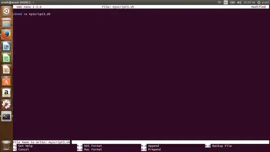

step 1 this pic is for the first command. I did it with another name. First Image

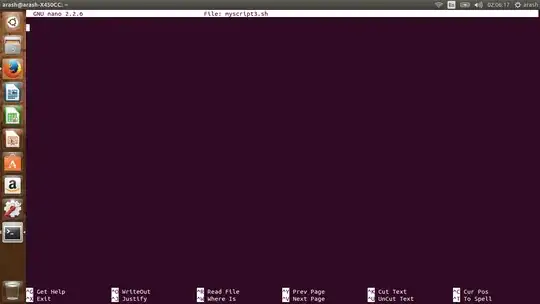

step 2 the next pic. for the next step after pressing ctrl+o to save. then I pressed enter. Second Image
